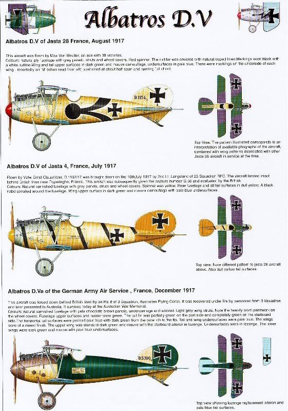

Albatros D.V(a) in combat.

The Albatros vee-strutters (D.III and V) were an attempt to give the Albatros D.II more of the maneuverability enjoyed by the Nieuport 11, 16, and 17. Pfalz went so far as to build a more or less straight copy of the Nieuport.
Comments about the Albatros D.V /Va should be seen in context. The Albatros D.III was the best German fighter when it appeared and was in its heyday in April 1917 and continued in production until May 1918 alongside the D.V/Va. Richthofen also flew the OAW build D.III at times. Indeed in Jasta lineups photos of Jasta 28w and Jasta 27 and other units you can see that the Jastaführers of these units, Karl-Emil Schäfer, Otto Hartmann, Hermann Göring, and countless others continued to fly the D.III. The retrofit, while not entirely solving the problem eased the fears of the pilots enough to let them focus on their task, which they did very well. The D.V appeared during this time, but the performance was not as great an improvement as the D.III had been over the D.II. (except diving) Although von Richthofen disliked the type he flew it and recognized it was the best that they had. And, he did well in it. 60 victories on the Albatros D.I,II,III, and V are not shabby at all. Consider the remark made by Paul Strähle of Jasta 18 and later of Jasta 57. He said that in his opinion it was the equal of the Fokker D.VII. A surprising remark, but he was there, and we weren't. (see the Smithsonian Albatros D.Va book by Robert Mikesh) Richthofen's comments about the "lousy Albatroses" was made to serve a purpose. He said that to get those back at Idflieg to stop resting on their laurels and foster support for more competition between manufacturers. (Perhaps he overstated it to make a point, his opinion, although highly regarded, still had to be carefully floated to the right people who could do something about the situation. He was, after all, a junior officer.)
Someone stated that why not put the BMW IIIa engine in the D.II? Albatros tested that engine in a variety of the D. type airframe combinations and there was no appreciable improvement to warrant a contract. Besides, by 1918, the Albatros was a late 1916-early 1917 design. As we have seen, the Fokker D.VII and some other designs were to take the limelight as far as the pilot's aspirations were concerned. But, the Albatros D.V and D.III (OAW) soldiered on for that matter, much like the ME-109 would in a later war although surpassed by superior designs.
